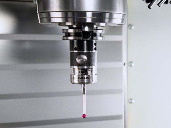

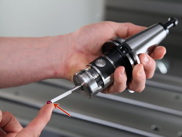

  1. How to Calibrate WIPS, Verify Probe is Functioning Properly: step 1, image 1 of 3 How to Calibrate WIPS, Verify Probe is Functioning Properly: step 1, image 2 of 3 How to Calibrate WIPS, Verify Probe is Functioning Properly: step 1, image 3 of 3
    • Check that the probe system and connections to the machine are functioning correctly.
    • Parts Required for this Step: 12133, 13131, 43121, 48382, 28392, 28210, 1111.
    • Reminder: Make sure to remove the spindle before starting the process.
    • Before beginning this procedure check to see if the fuse is dead. If the fuse is dead go here.
    • Note: View the Ring Gauge item page for more detailed part information.
    • Refer to the Wiring Diagram prior to starting step 4.

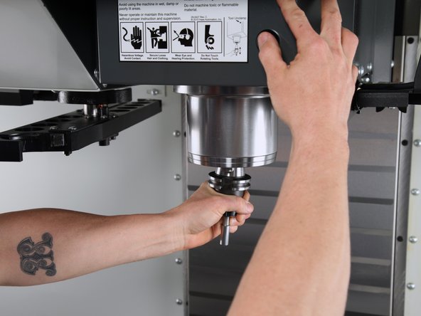

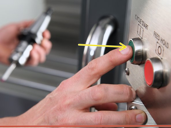

  2. How to Calibrate WIPS: step 2, image 1 of 2 How to Calibrate WIPS: step 2, image 2 of 2

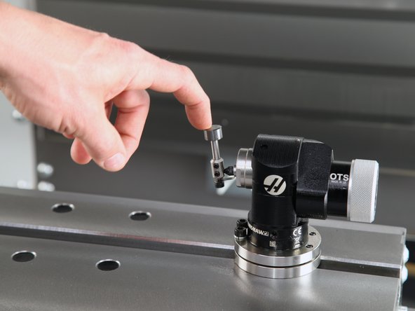

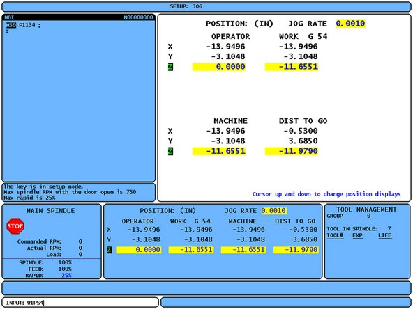

    • In MDI, enter: M59 P1134.
    • Hold the Work Probe within range of the OMI. Press and Hold CYCLE START.
    • Gently depress the stylus, the control pendant will beep indicating the probe is activated.
    • View MSDS here
    • Contact Supervisor is there is a problem
    • Rotate the probe by hand to check runout.
    • If runout exceeds 0.0005" or 0.013 mm, adjustment is required.
    • Enter the runout reading.

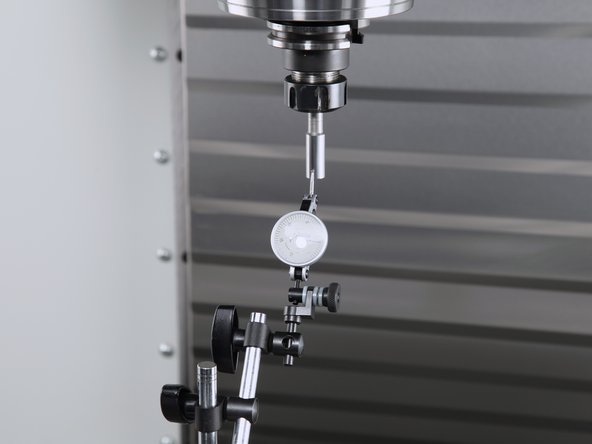

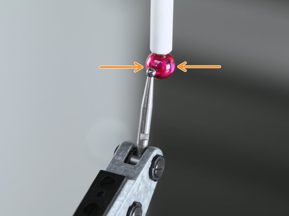

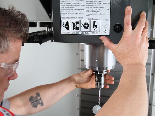

  4. How to Calibrate WIPS, Adjust stylus runout: step 5, image 1 of 3 How to Calibrate WIPS, Adjust stylus runout: step 5, image 2 of 3 How to Calibrate WIPS, Adjust stylus runout: step 5, image 3 of 3

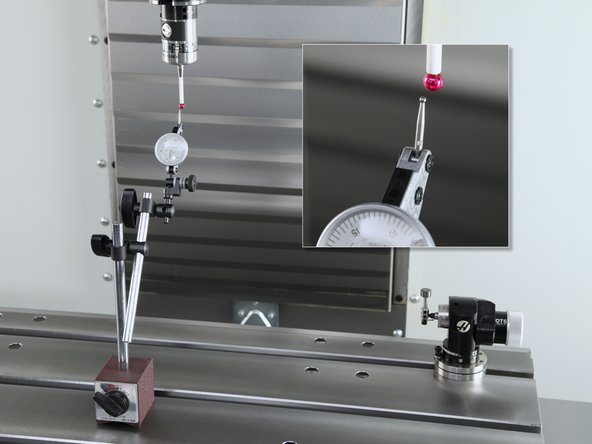

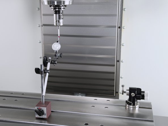

    • Insert the Work Probe into the spindle.
    • Place the magnetic base on the table and align the indicator tip to the probe's stylus.
    • Jog the axes in 0.001 inch increments until the indicator touches the stylus.
    • With the indicator tip set against the stylus press E-STOP, so the probe isn’t accidentally ejected during adjustment.

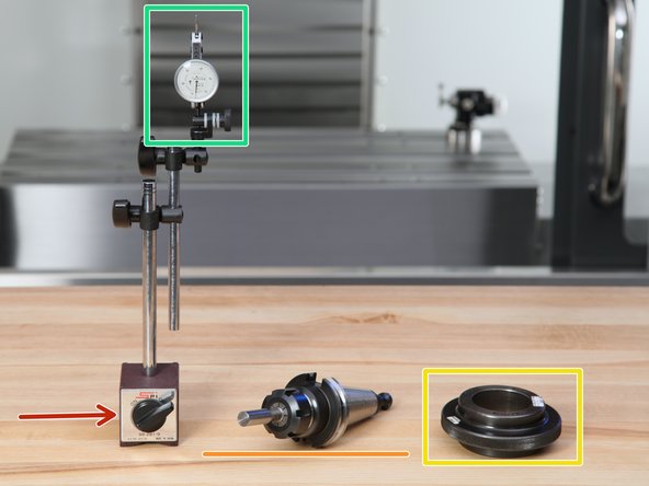

  5. How to Calibrate WIPS, Calibration Tools:: step 6, image 1 of 3 How to Calibrate WIPS, Calibration Tools:: step 6, image 2 of 3 How to Calibrate WIPS, Calibration Tools:: step 6, image 3 of 3

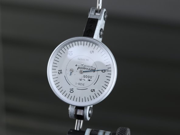

    • Magnetic Base to mount the Indicator
    • "Calibration Bar", generally consisting of a 1/2" or 12 mm gauge pin clamped in a collet style toolholder.
    • Test Indicator accurate to 0.0005" or 0.013 mm
    • An accurately bored hole in a part or fixture can also be used in place of the Ring Gauge fixture.

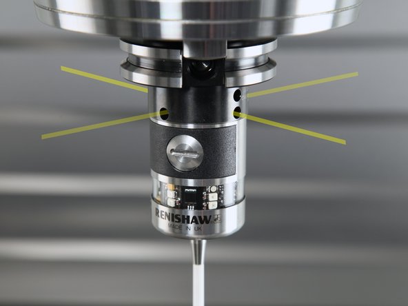

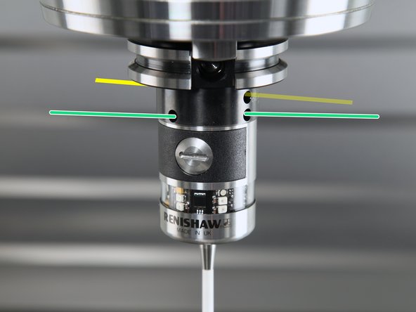

  6. How to Calibrate WIPS: step 8, image 1 of 3 How to Calibrate WIPS: step 8, image 2 of 3 How to Calibrate WIPS: step 8, image 3 of 3

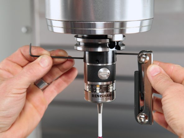

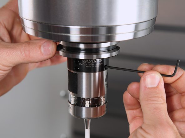

    • On the probe body, loosen the two upper LOCKING set screws slightly, and then lightly tighten them.
    • WARNING: The four lower sets of screws adjust the position of the stylus mount. Very small adjustments have a large effect on the stylus runout.
    • Decide which dirsdfgsdfgn the stylus needs to be adjusted to reduce runout.
    • Loosen and then slightly tighten the two opposing screws that are NOT inline with this direction to add some friction.

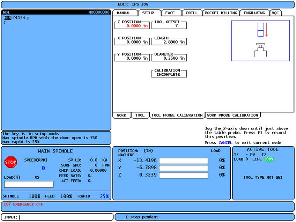

  7. How to Calibrate WIPS: step 9, image 1 of 2 How to Calibrate WIPS: step 9, image 2 of 2
    • The WIPS Calibration Menus are explained in the Haas VMC Operator's Manual.
    • Press MDI/DNC.
    • Press PRGRM/CONVRS.
    • Select the SETUP tab.
    • Select the TOOL PROBE CALIBRATION tab.

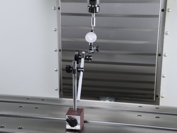

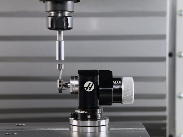

    • Insert the Calibration Bar into the spindle.
  8. How to Calibrate WIPS: step 10, image 1 of 1
    • With the Indicator mounted on the table, measure the runout of the Calibration Bar gauge pin.
    • If runout exceeds 0.0005 inches or 0.013 mm the bar will need to be adjusted or replaced.

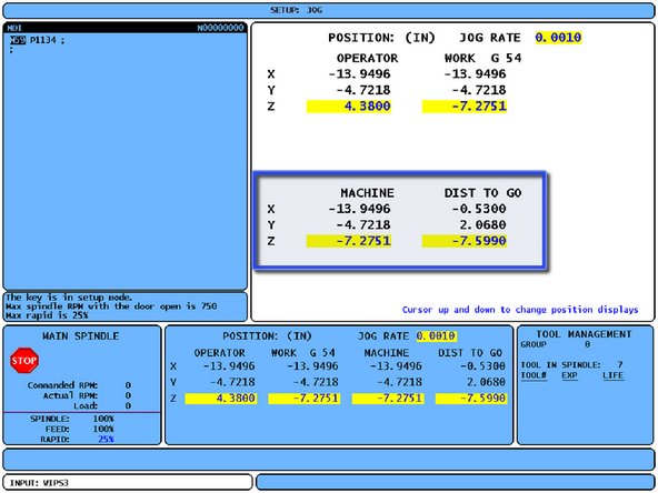

    • Using the Z-axis and an indicator, check the distance from the face of the spindle to the tip of the gauge pin.
    • This is NOT a Gauge Line measurement.
    • Use this method consistently to measure the Calibration Bar and the results will always be repeatable for quality work.

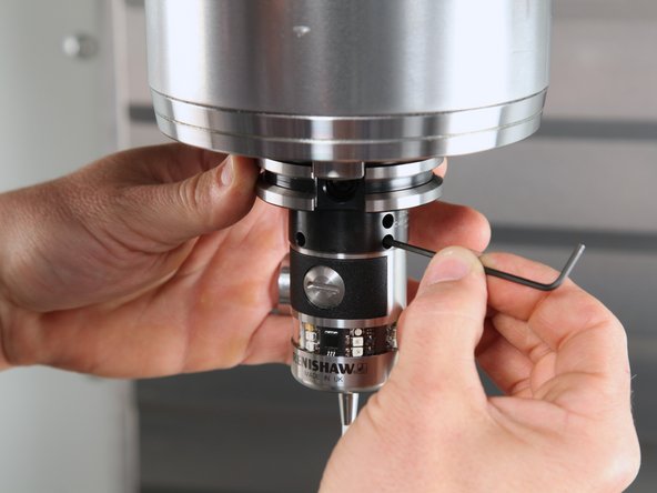

  10. How to Calibrate WIPS: step 12, image 1 of 2 How to Calibrate WIPS: step 12, image 2 of 2
    • Continue to adjust inward with each set of screws to reduce the runout as close to zero as possible.
    • When runout is below 0.0005" or 0.013 mm, carefully tighten each upper locking screw while at the same time tightening the opposite lower adjustment screw.
    • Then do the other set.

    • Note the on-screen Z-axis value, this is your Calibration Bar length.
    • Write this value on a piece of paper.

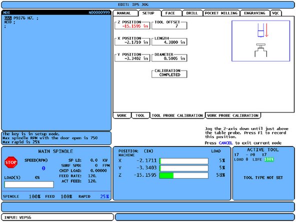

  12. How to Calibrate WIPS: step 14, image 1 of 2 How to Calibrate WIPS: step 14, image 2 of 2

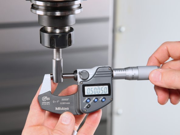

    • Use a micrometer to find the diameter of the gauge pin used in the Calibration Bar and write this number down.
    • Follow the on-screen prompts. Jogging Z-axis, bring the calibration bar just above the tool probe, and press F1.
    • Then Jog the X axis to center the bar over the tool probe and press F1 again. Do the same for the Y axis.
    • Enter the tool number you will use for the Calibration Bar.
    • Press CYCLE START to execute the automatic calibration routine.
    • The Calibration Bar will touch off the top of the Tool Probe, and in four places on the side of the probe.

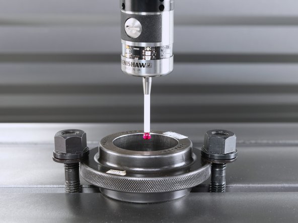

  13. How to Calibrate WIPS: step 16, image 1 of 2 How to Calibrate WIPS: step 16, image 2 of 2
    • When the program is finished, the CALIBRATION status box will display COMPLETED. Calibration of the Work Probe can begin.
    • Press CANCEL and select the Work Probe Calibration tab.

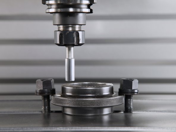

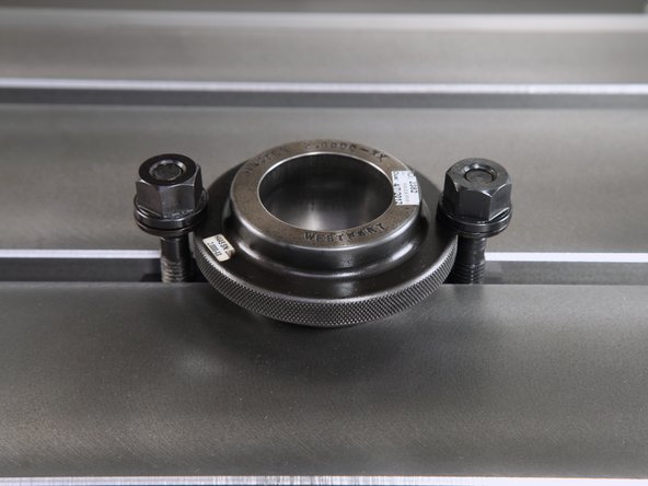

    • Clamp the Ring Gauge to the table within reach of the probe.
    • Enter the Work Offset to be used for Work Probe calibration.

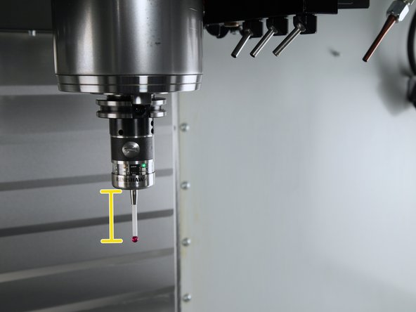

  14. How to Calibrate WIPS: step 17, image 1 of 2 How to Calibrate WIPS: step 17, image 2 of 2

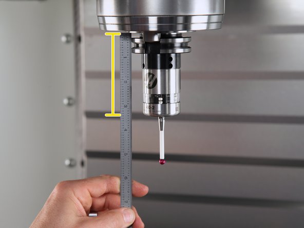

    • Remove the calibration bar from the spindle and insert the Work Probe in its place.
    • Measure the Work Probe length with a machinist’s scale (accuracy of 1/16 inch or 1.5 mm).
    • Note that the standard Renishaw probe uses a 0.2362 inch or 6 mm diameter ball.
    • Now enter the length of the Work Probe as well as the diameter of the indicating ball.
  15. How to Calibrate WIPS: step 18, image 1 of 2 How to Calibrate WIPS: step 18, image 2 of 2

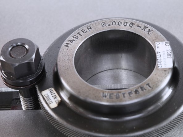

    • Measure the ring gauge with an inside micrometer or bore gauge.
    • If the Inside Diameter is etched on the Gauge, that number can be used.
    • Next enter the diameter of the Ring Gauge and press WRITE/ENTER.

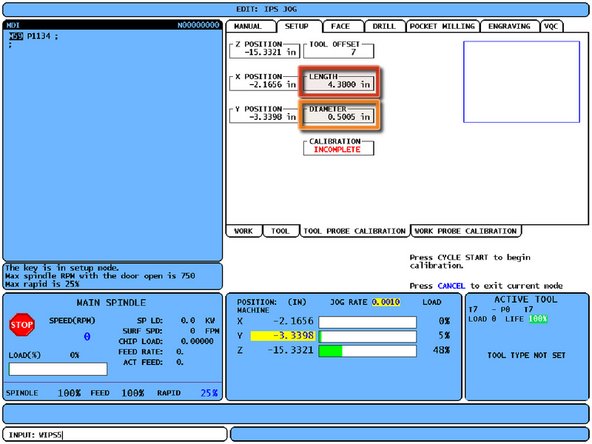

  16. How to Calibrate WIPS: step 19, image 1 of 1
    • Now enter the Calibration Bar length. Use the value you wrote down in Step 15.
    • Next, enter the micrometer reading previously noted in Step 16.
    • WARNING: THIS MUST BE A DIAMETER AND NOT A RADIUS MEASUREMENT.

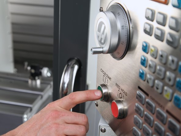

    • In MDI Mode, enter: M59 P1133; G04 P1.0: M59 P1134.
    • With the doors open, press and hold CYCLE START.
    • After the program has run, gently tap the Tool Probe with your finger.
    • The control pendant will beep each time the Tool Probe is depressed. The Tool Probe is activated.
    • Press RESET to end the activation.

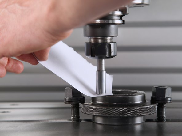

    • With the calibration bar in the spindle, position the pin above the edge of the ring gauge.
    • Place a shim, feeler gauge, or slip of paper over the gauge.
    • Press the .0001/.1 button. Jog the Z-axis so the tip of the bar slightly contacts the paper. Press F1.
    • Enter the length of the calibration bar from Step 15. Press the WRITE/ENTER button.
    • Enter the thickness of the shim used, in this case a piece of paper at 0.003 inch. Press WRITE/ENTER again.
