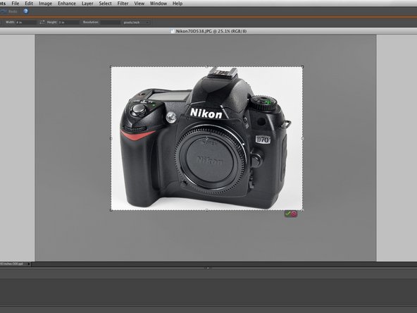

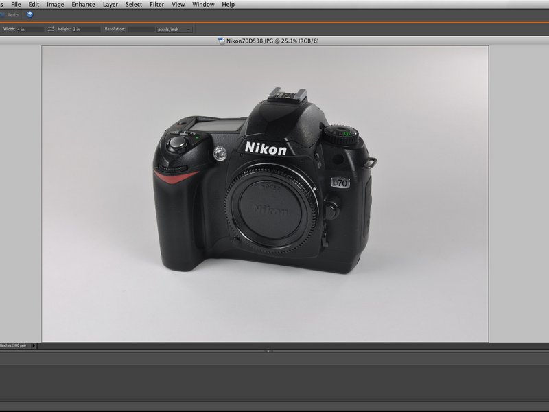

      • Here is a bare bones photo of a Nikon D70 camera. The picture is pretty good, but it could be improved in a few areas.
      • The photo is too dark. It has incorrect colors. Additionally, the photo has some physical imperfections, and it is not in the correct aspect ratio.

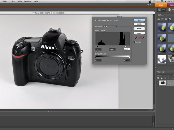

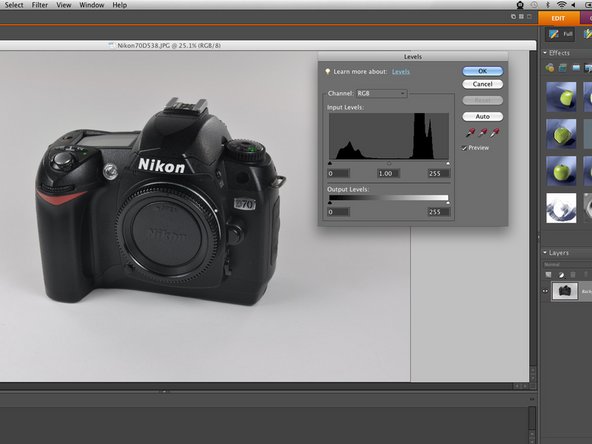

      • Adjusting the light levels is a good way to start editing your photos. Adjusting the light levels allows you to balance whites and blacks properly.
      • Note that each side of the level graph contains multiple peaks. A good rule of thumb is to shift the light level sliders to just before the peaks on their respective sides.

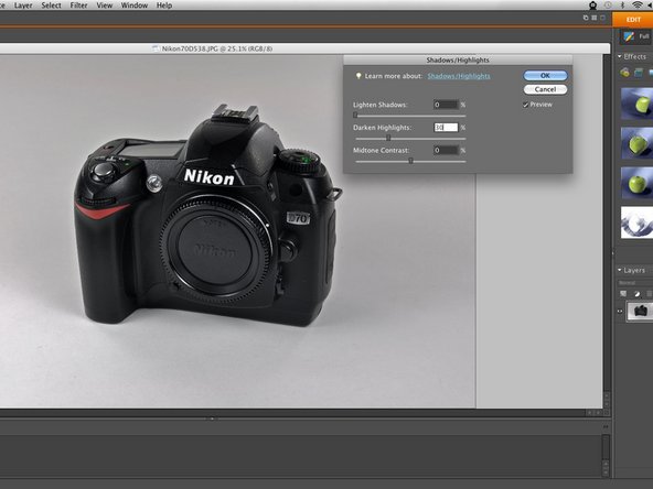

    2. How to Post-Process Pictures, Shadows/Highlights: step 2, image 1 of 3 How to Post-Process Pictures, Shadows/Highlights: step 2, image 2 of 3 How to Post-Process Pictures, Shadows/Highlights: step 2, image 3 of 3

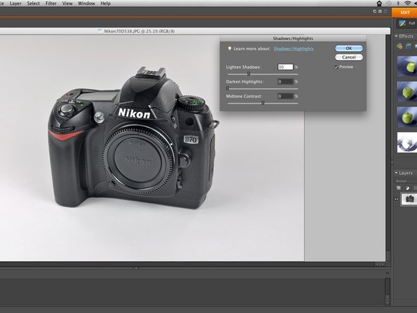

      • Adjusting the light levels may not be enough to even out all the darks and lights in a picture. To further correct the picture, adjust the shadows and highlights.
      • Adjusting midtone contrast increases or decreases the difference between darks and lights in your photo. You can see in the first image that there is a greater difference between the two than before adjusting the mid-tone contrast.
      • Darkening highlights is useful for darkening particularly light spots in a picture without having to select that specific area.
      • The Lighten Shadows tool is used for lightening particularly dark spots. Spots that contain detail (like the Nikon logo over the lens) may appear solid black; lightening the shadows brings out the detail.
      • Use this tool only in small doses, as black objects are usually considered "shadows" in a program, and they will be lightened as well. Overuse of this function may result in grainy spots.

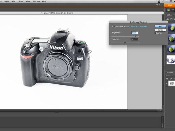

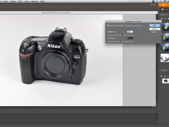

    3. How to Post-Process Pictures, Brightness/Contrast: step 3, image 1 of 3 How to Post-Process Pictures, Brightness/Contrast: step 3, image 2 of 3 How to Post-Process Pictures, Brightness/Contrast: step 3, image 3 of 3

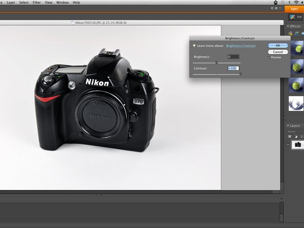

      • Brightness and contrast adjustment is an effective tool to perfect the lighting of your photo.
      • Increasing brightness is the equivalent of adding light to the entire picture. The first picture shows an overly brightened picture, revealing exaggerated effects.
      • Contrast, like mid-tone contrast, will simultaneously adjust darks and lights relative to each other. The second picture shows a high contrast setting which has caused the darks to become very deep, and the whites create a glare.
      • For this picture, a slight increase in brightness is enough to properly light the object of the picture.

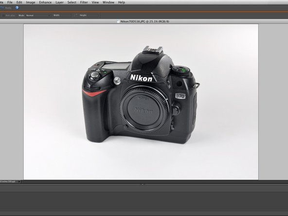

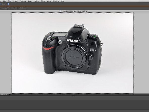

    4. How to Post-Process Pictures: step 4, image 1 of 2 How to Post-Process Pictures: step 4, image 2 of 2

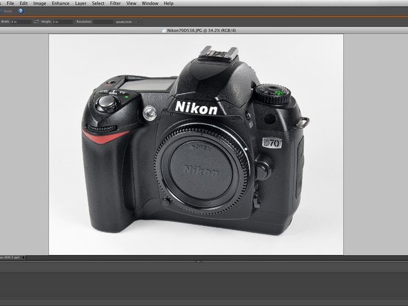

      • Editing the entire picture will not always achieve the desired results. For example, the background in this picture is dark and contains undesired colors, so we will select everything but the camera.
      • Selecting specific spots allows you to eliminate particular issues and edit a picture to perfection.

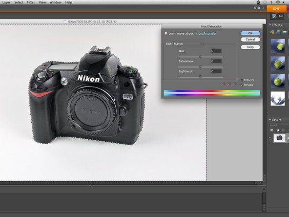

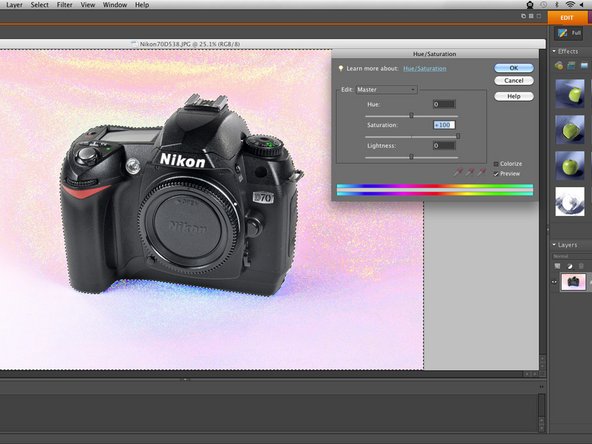

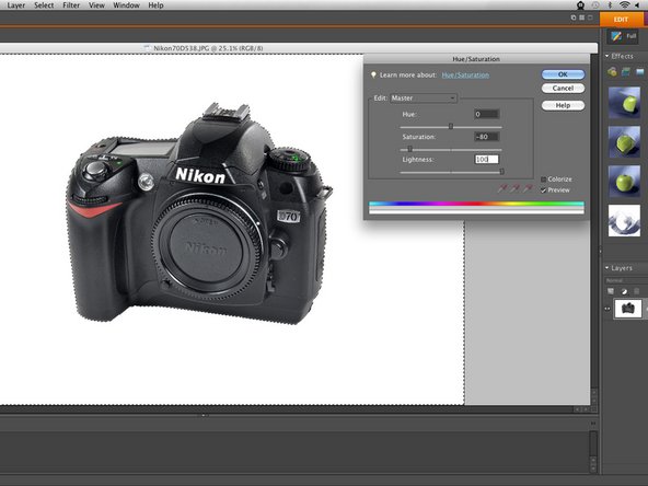

    5. How to Post-Process Pictures, Hue/Saturation: step 5, image 1 of 3 How to Post-Process Pictures, Hue/Saturation: step 5, image 2 of 3 How to Post-Process Pictures, Hue/Saturation: step 5, image 3 of 3
      • Adjusting color hues and saturation is an efficient way to correct color errors in the background or a specific spot in the photo.
      • Over saturating the "main" color exposes what colors are present, thus allowing you to adjust the desired colors.
      • We find that our background contains an excess of reds, blues, and yellows.
      • In this case, we want a white background, so we drastically reduce the saturation and increase the lightness under main to easily reduce all backgrounds colors.
      • In other cases, adjust the saturation, hue, and lightness of individual colors to achieve the desired look.

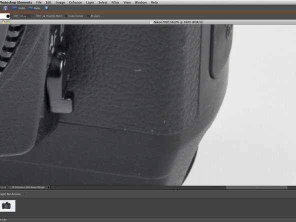

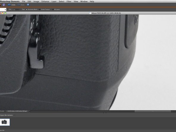

    6. How to Post-Process Pictures, Spot Healing: step 6, image 1 of 2 How to Post-Process Pictures, Spot Healing: step 6, image 2 of 2
      • Not all work environments are perfectly clean. Subjects may be blemished with hair, dust, dirt, or other imperfections. If possible, major offenders should be removed.
      • Spot Healing and Clone Stamp tools are particularly useful for erasing imperfections without greatly affecting textured surfaces.
      • Notice the removal of the blemishes on the camera from picture one to picture two.
      • Using details from the surrounding area, the Spot Healing tool used on this picture takes an imperfection and edits over it. It is a tool for fixing small blemishes (like the specks in our photo).
      • The Clone Stamp tool is similar to the spot healing tool except you manually select the area from which you copy. This tool works for larger edits, but it may require some extra touching-up to get the correct look.
      • Some imperfections may not be visible when placed into the smaller guide windows, but they may be easily seen if the full-sized image is viewed. Consider whether or not the imperfection would be visible under the greatest available zoom.

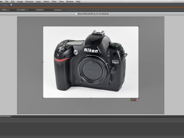

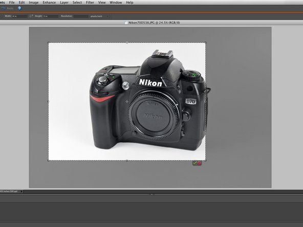

    7. How to Post-Process Pictures, Cropping: step 7, image 1 of 3 How to Post-Process Pictures, Cropping: step 7, image 2 of 3 How to Post-Process Pictures, Cropping: step 7, image 3 of 3
      • The last step is to crop your picture to a 4:3 aspect ratio. iFixit guides will not accept images of a different ratio.
      • A key to cropping photos is to make sure that the subject of the photo is large enough, while also not so large that it overpowers the picture area. For example, the first picture is cropped too tightly as many edges contain very little white space.
      • The second picture has correct vertical margins, but it has incorrect centering.
      • The third picture shows a correct picture crop, as there is some white space around the centered subject.
      • Cropping perfectly centered on the subject may not always be desirable. If there is a desired part or action on the subject, you need to center the crop around that area. This often entails cropping part of the subject out of the picture.
