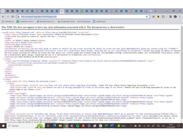

      • Open the guide you wish to translate in your browser.
      • You'll find a five or six digit number in the URL - it's "152974" in the example shown in the picture.
      • Copy this number, and open another tab. Then fill in this information in the URL field: www.ifixit.com/api/2.0/guides/NUMBERCODE?type=xml
      • The copied number code of the guide you want to translate should be pasted between the last backslash and the question mark where you see “NUMBERCODE”.
      • This way, you will get this URL: www.ifixit.com/api/2.0/guides/152974?type=xml

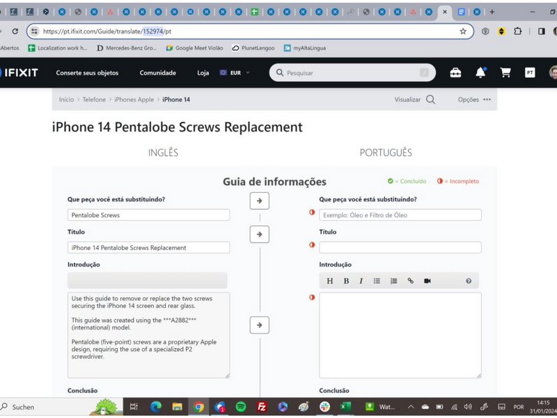

    2. How to import guides in an XML format into a CAT-Tool: step 3, image 1 of 1
      • Hit ENTER to open the XML file in your browser. You will obtain a view like in the picture here.
      • Save the file in the folder you intend to save all files of your CAT tool project.
