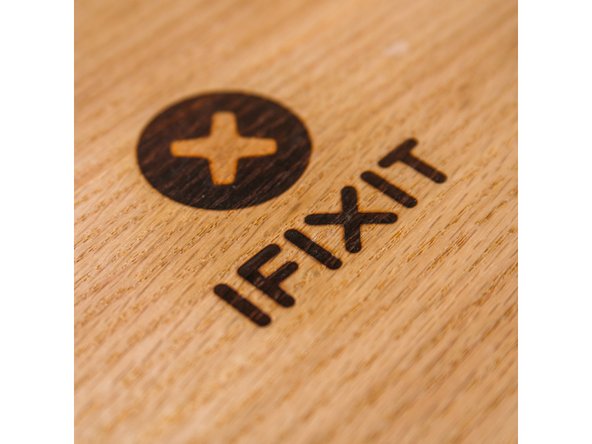

    2. How to Adjust Camera Settings, Shutter speed: step 2, image 1 of 3 How to Adjust Camera Settings, Shutter speed: step 2, image 2 of 3 How to Adjust Camera Settings, Shutter speed: step 2, image 3 of 3
      • Adjusting the shutter speed allows more or less light to expose the image. In these example images, ISO and f-stop settings remained constant, but shutter speed was adjusted as follows:
      • Image 1: 1/200 second shutter speed
      • Image 2: 1/60 second shutter speed
      • Image 3: 1/10 second shutter speed
      • The slower the shutter speed, the more light is allowed into the camera.
      • However, the slower the shutter speed, the higher the chance that the image will be blurry.
      • All of these photos were taken with a tripod and remote-fire software, so blurriness was minimized during slower exposures.

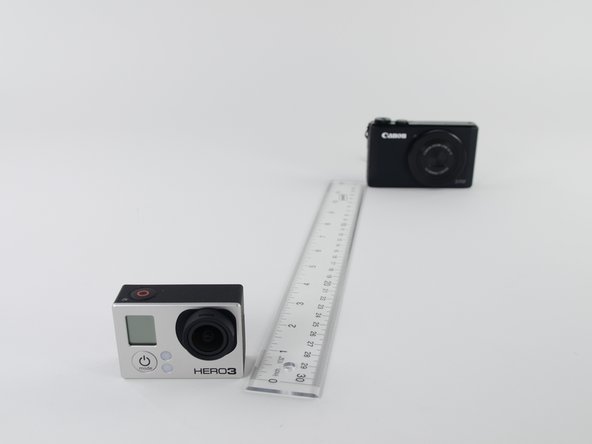

    3. How to Adjust Camera Settings, f-stop: step 3, image 1 of 3 How to Adjust Camera Settings, f-stop: step 3, image 2 of 3 How to Adjust Camera Settings, f-stop: step 3, image 3 of 3
      • Every camera lens has a multi-bladed diaphragm called the aperture. The aperture opens to different diameters to permit more or less light into the camera. A measure of that diameter is called the "f-stop." Here is a quick rundown on what the f-stop setting on your camera will do to your photos.
      • Image 1: f-stop of 3.2. Notice how the Canon camera in the background is out of focus.
      • Image 2: f-stop of 8. The Canon camera is now more in focus, as are parts of the ruler.
      • Image 3: f-stop of 16. The Canon camera is now mostly in focus.
      • So why not shoot at f/16 all the time?
      • Two costs: image quality (higher f-stop settings result in less-sharp images overall) and shutter speed. Higher f-stop settings require a longer exposure to capture the same amount of light, increasing the chances for a blurry photo.

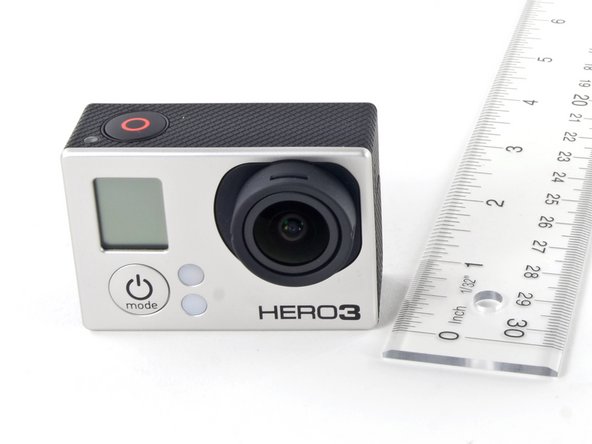

    4. How to Adjust Camera Settings, ISO: step 4, image 1 of 2 How to Adjust Camera Settings, ISO: step 4, image 2 of 2
      • ISO is a measure of a camera's sensitivity to light, and should be kept at the lowest possible value. High ISO values lead to very grainy pictures, but they allow you to increase shutter speed.
      • Image 1: ISO 100 setting
      • Image 2: ISO 6400 setting

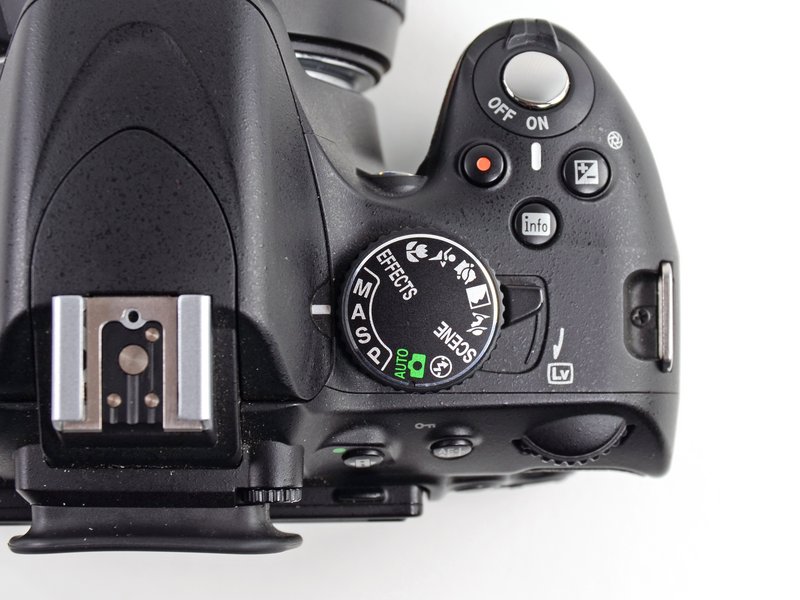

    6. How to Adjust Camera Settings, Aperture Priority Mode: step 6, image 1 of 1
      • Most "pro" cameras have an Aperture Priority shooting mode, denoted by an A or Av on the mode dial. It is quite easy to take photos in this mode, since all you have to worry about is the ISO and f-stop settings; the camera will figure out exposure for you.
      • How it works: the camera automatically adjusts the shutter speed to keep the exposure constant, while the f-stop and ISO settings can be modified based on the amount of light available in the environment.
      • One small caveat: if the ISO and f-stop settings are not adjusted properly, the shutter speed may fall below 1/40 of a second. This may inhibit taking crisp, hand-held shots with the camera.

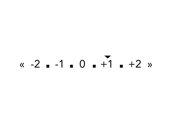

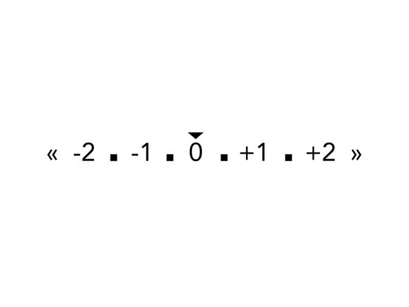

    7. How to Adjust Camera Settings, Exposure Compensation: step 7, image 1 of 2 How to Adjust Camera Settings, Exposure Compensation: step 7, image 2 of 2
      • Exposure compensation is an easy way to adjust the camera's shutter speed while using Aperture Priority mode to achieve a brighter or darker image.
      • For a given aperture, a negative EV sets a shorter shutter speed and makes the picture darker. A positive EV keeps the shutter open a little longer, allowing in more light and making the picture brighter.
      • In the example images, the EV setting was changed from 0 to +1, which will make all subsequent shots a bit brighter than before. This comes at the expense of a slower shutter speed.
