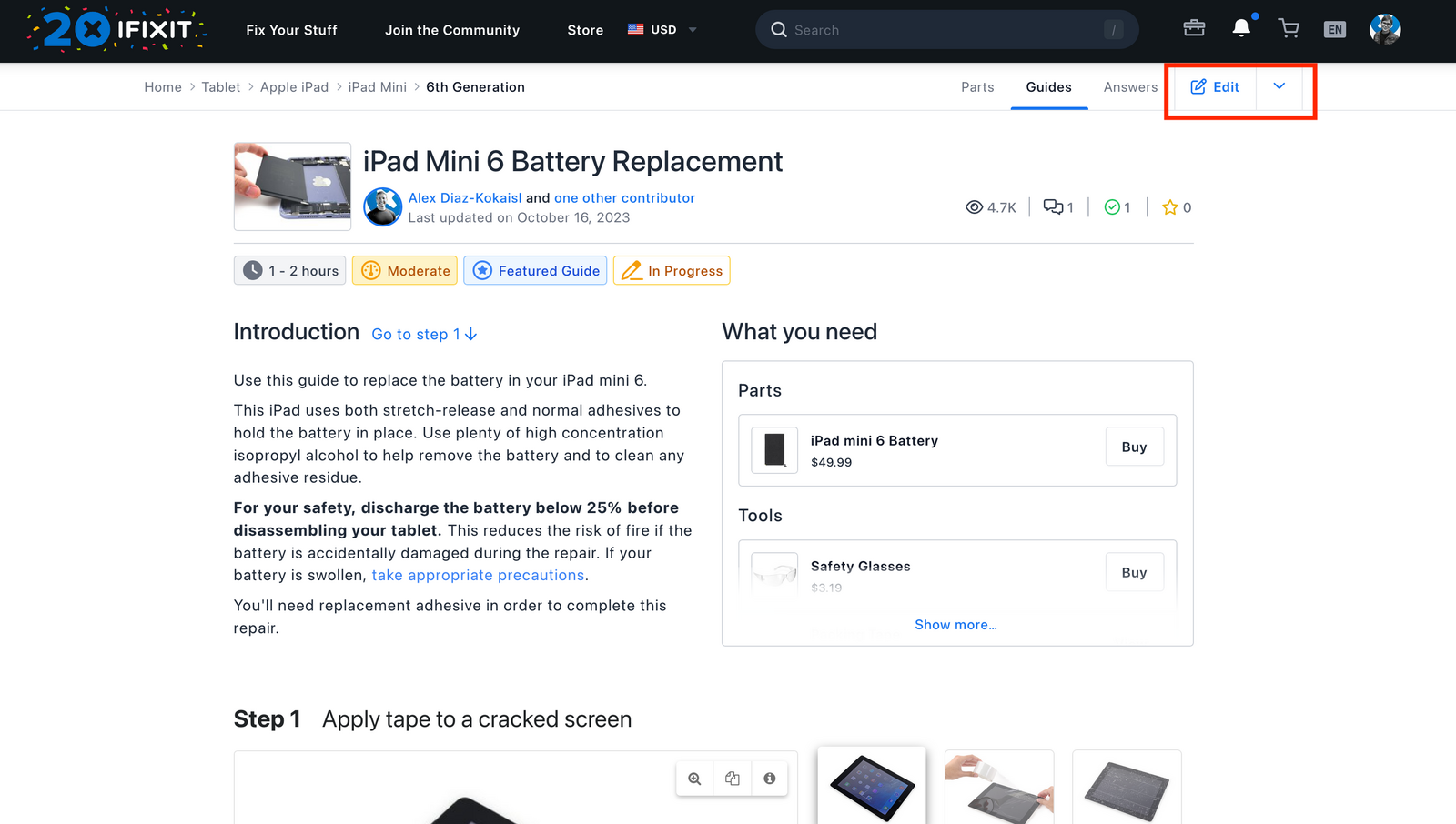

Edit, Full Screen, and Options
The first page of a guide features two options which are located in the top-right of the page: Edit and Dropdown caret.

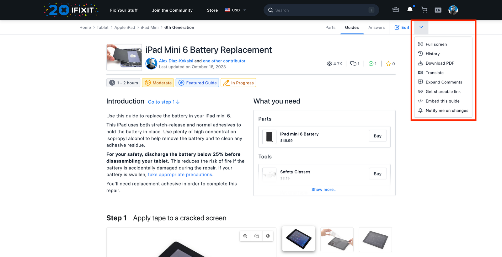

Once the menu drops down you will see eight options from you to choose from: Full Screen, History, Download PDF, Translate, Expand Comments, Get Sharable Link, Embed This Guide, and Notify Me of Any Changes.
Edit
Click Edit to add and edit the elements of your guide page. Guide editing is organized under three sub-sections: Introduction, Details, and Guide Steps.

Full Screen
Click Full Screen to view the guide in full screen mode. This is typically what a user will see/use when completing a guide on a mobile device/tablet.
History
A guide's history shows you the entire timeline of changes to the guide. You can even revert back to any previous state. The History option allows you to view the entire revision history for a guide page. You can view the history chronologically according to the revisions’ dates and times.
This link takes you to the Guide History wiki where you can gain more in-depth knowledge of the parts of the history page.
Save to Favorites
When a you favorite a guide, that guide is added to your User Profile under the section My Favorite Guides.
Use this link for further instruction on Save to Favorites.
Download PDF
To view your guide offline, you can download it as a PDF. Downloading a PDF version of your guide is super easy. In the Options menu, Select Download PDF, and a PDF file of your guide will open.
Translate
The languages currently supported can be viewed here.
With this link to our Languages Help Documentation, you will find a number of helpful guides for translating your guides, both manual and machine translations.
Expand and Collapse Comments
The Expand Comments option gives you the opportunity to read comments that have been posted for or about your guide.
When you select Expand Comments, scroll down to the bottom of the guide page to the Comments section. If users have commented on your guide, you will see a username link to their profile page. Click the link to view users who have commented on your guide. Near the bottom of their profile page, you will find a link to their comments on your guide, under Guide Comments. Once you have read the comments, or if you want the comments to be concealed, select Collapse Comments from the Options drop-down menu.
This feature is a quick and easy way to create a link that you can copy and share with others.
Embed This Guide
Select Embed this Guide to embed a guide as a small widget on your site/forum. The feature allows you to choose the size that fits your need, and you can even preview your embed size selection!
Notify Me of Changes
Selecting Notify Me of Changes subscribes you to notifications for changes made to your guide.
