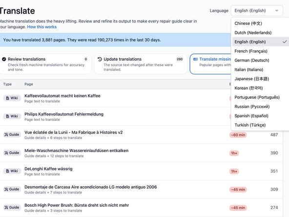

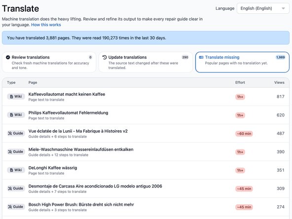

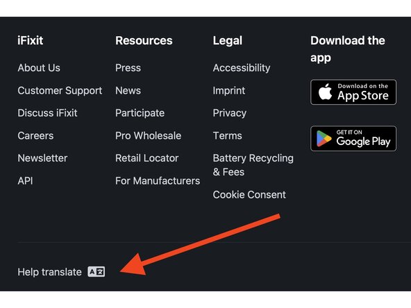

      • Select Help Translate in the footer to open the translation overview.
      • On Translate Missing, choose a wiki to translate. The page automatically shows content missing from the language you're currently browsing in.
      • To translate into a different language, use the language dropdown on the Translate Missing page.
      • If you choose a guide, follow How to Manually Translate Guides.

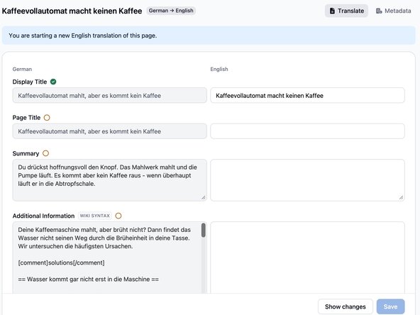

    2. How to Manually Translate Wikis: step 2, image 1 of 1
      • After you select a wiki, the translation interface opens automatically. The source language appears on the left, and the target-language fields appear on the right.
      • Enter the translation in the fields on the right.

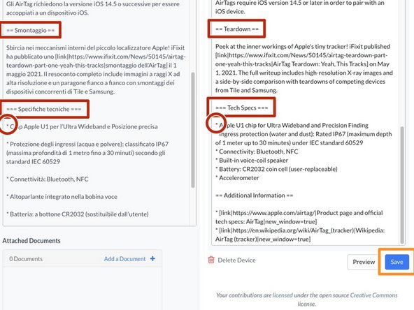

    3. How to Manually Translate Wikis: step 3, image 1 of 1
      • Translate the Display Title, Page Title, Summary, and additional information.
      • Preserve the wiki markup. Keep formatting characters such as = for headings and * for bullets. Learn more in Wiki Formatting and Syntax.
      • Select Save when you're finished or want to pause.
      • Translate each field while comparing it with the source on the left.
      • If you leave the translation interface, return to Translate Missing and select the wiki again to continue.

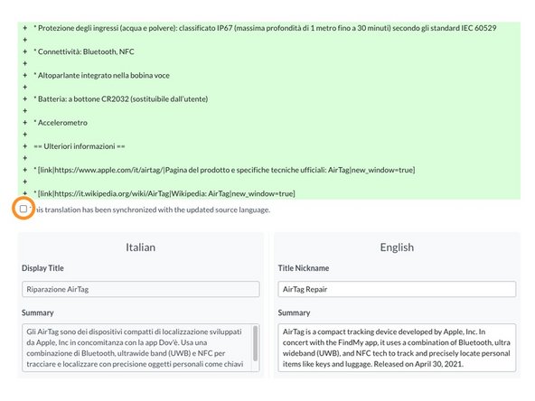

    4. How to Manually Translate Wikis, Update a wiki translation: step 5, image 1 of 3 How to Manually Translate Wikis, Update a wiki translation: step 5, image 2 of 3 How to Manually Translate Wikis, Update a wiki translation: step 5, image 3 of 3
      • If the wiki has been already translated and the original version later updated, you will see a banner saying This translation may be out of date.
      • Click on Show changes to expand them.
      • The deleted parts are marked in red, the added ones in green.
      • Make sure to take over all changes in your translation. After this, scroll to the bottom of the green-red changes section and check the box This translation has been synchronized with the updated source language. Now you can save your translation.
