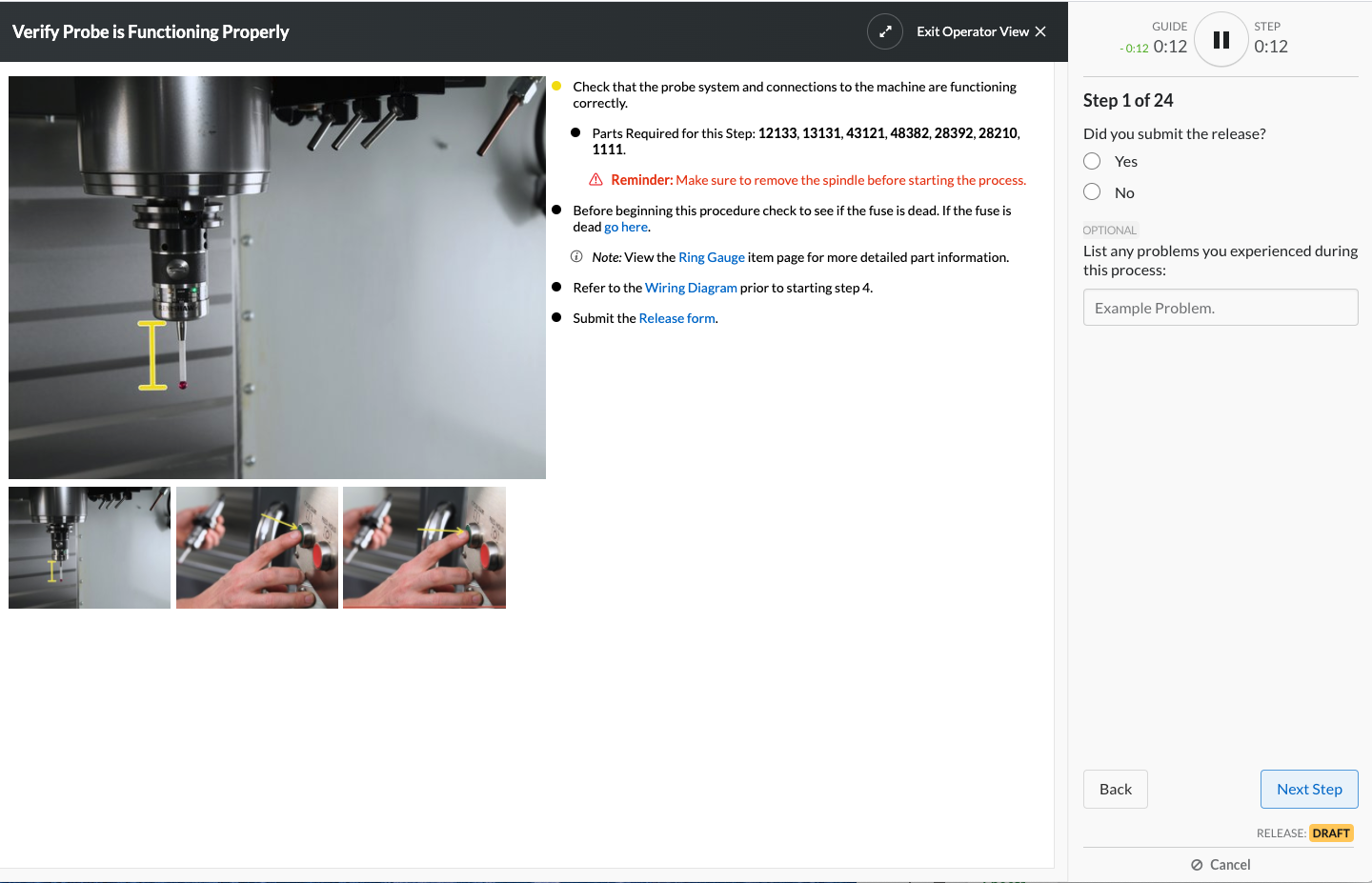

Want to capture critical information? Track users’ timing performance on procedures?
Operator View feature allows you to insert customizable data capture fields so you can collect essential information from your users as they complete a process.
From tracing product progress to ensuring quality standards, you can author prompts that meet all of your needs. Make this valuable data easily accessible by integrating with any of your preferred reporting tools or spreadsheet programs.

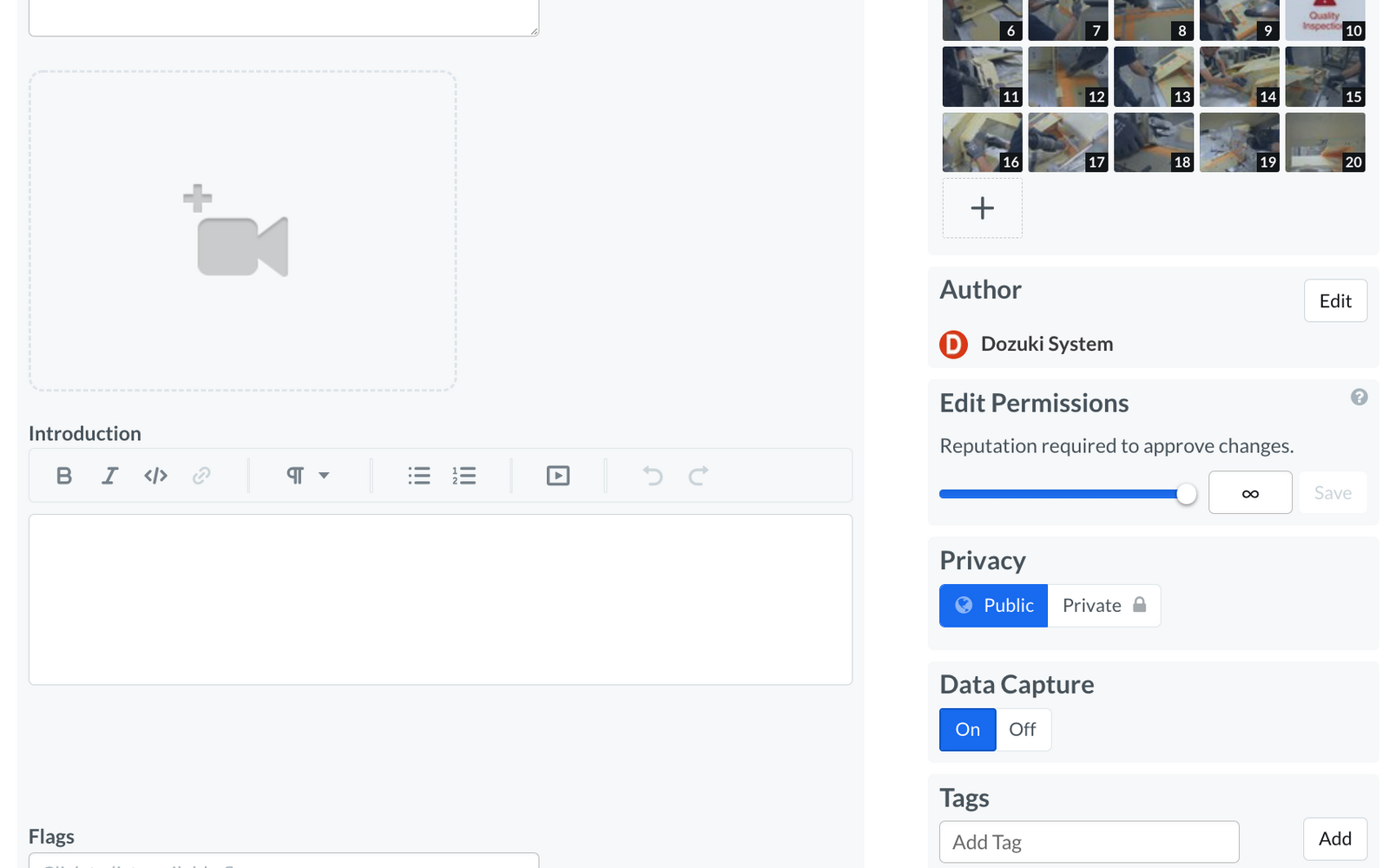

Activating Data Capture on a Guide
Each guide has a Data Capture On/Off Toggle Switch on the right-hand side of the Edit interface. When toggled On, Data Capture is activated, along with Operator View.
Note: You can disable Data Capture/Operator View on a guide at any point, and your data forms will not be lost. When you re-enable Data Capture/Operator View, all previous forms appear on each step that still exists in the guide.
